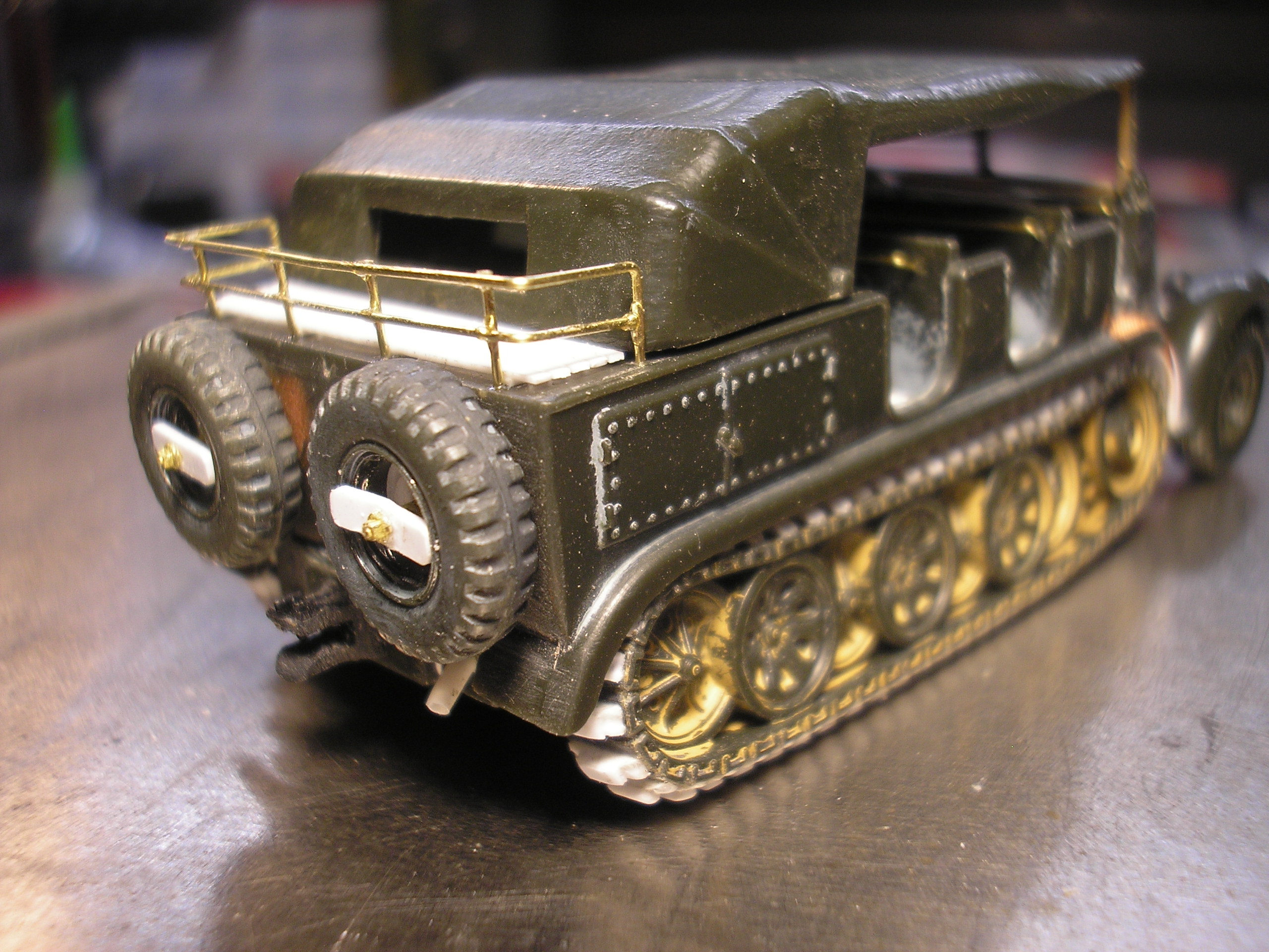

If you are not familiar with soldering techniques, you can also use super glue....here is a photo of a cargo rack I fabricated and assembled using super glue. When it cured, it is very strong.
I hope this is helpful.
Rick
