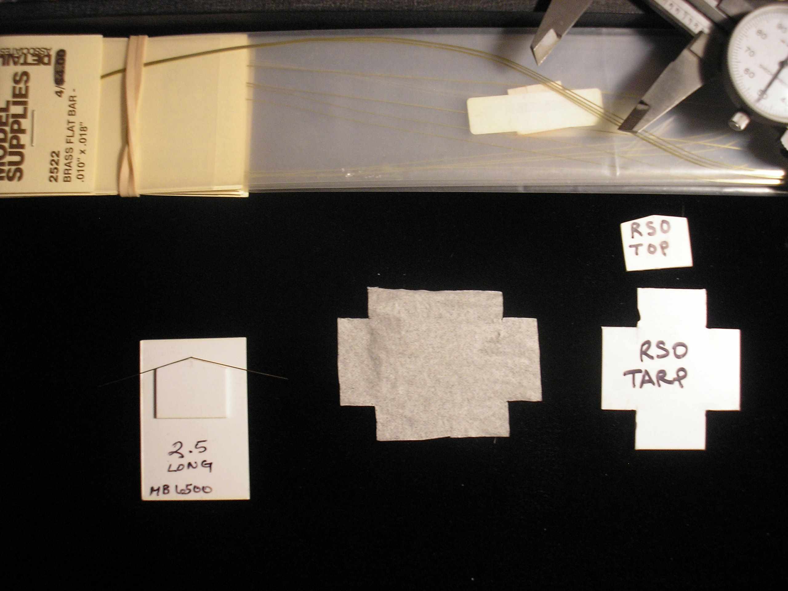

First a list of materials and special fixtures that I constructed to make the task a little less tedious. This is particularly effective if you have several tarps to do at one time and wish for some consistency in the construction process.
overall view.
overall view.

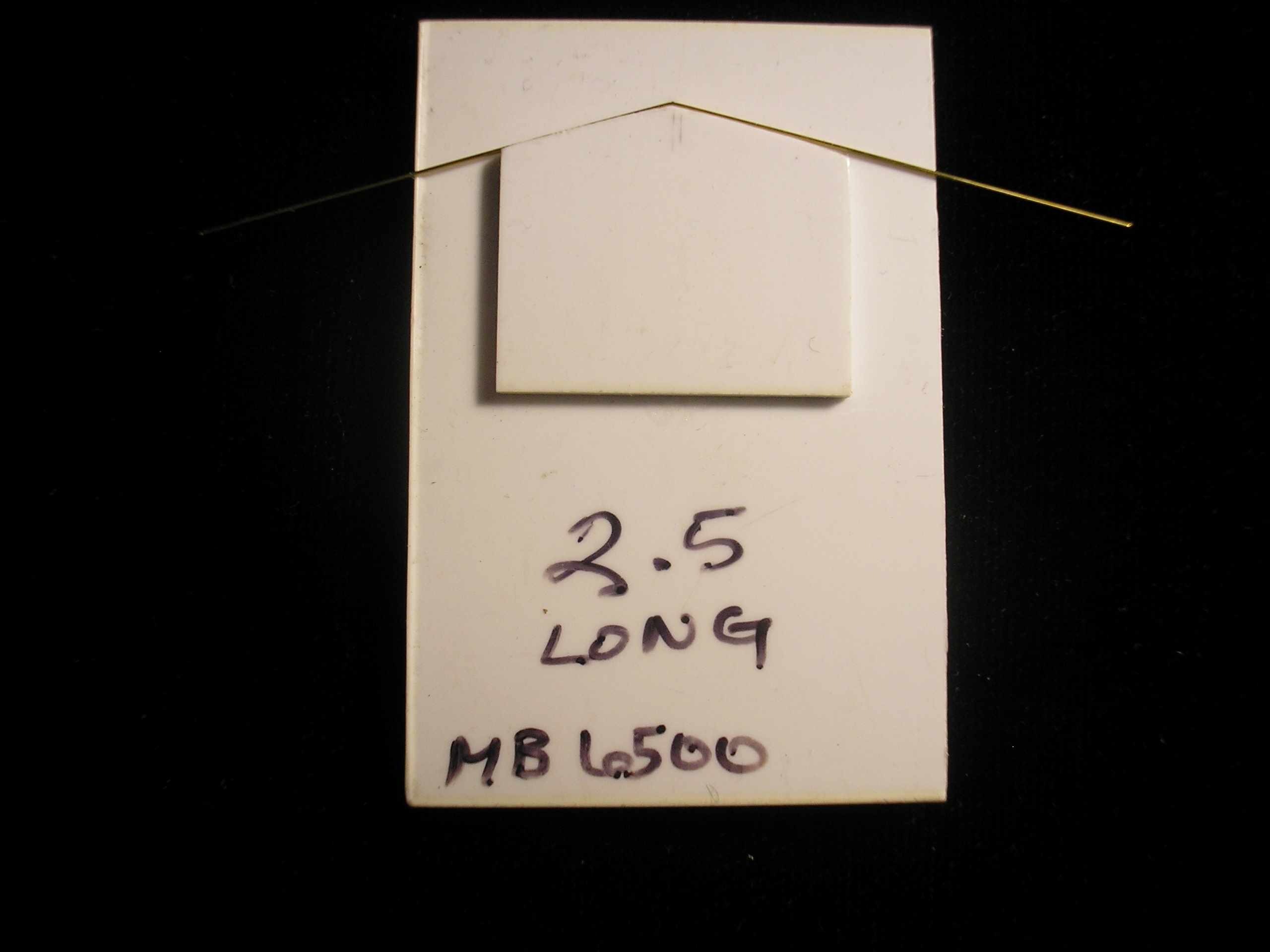

Tarp support fixture this is for a Mercedes 6500

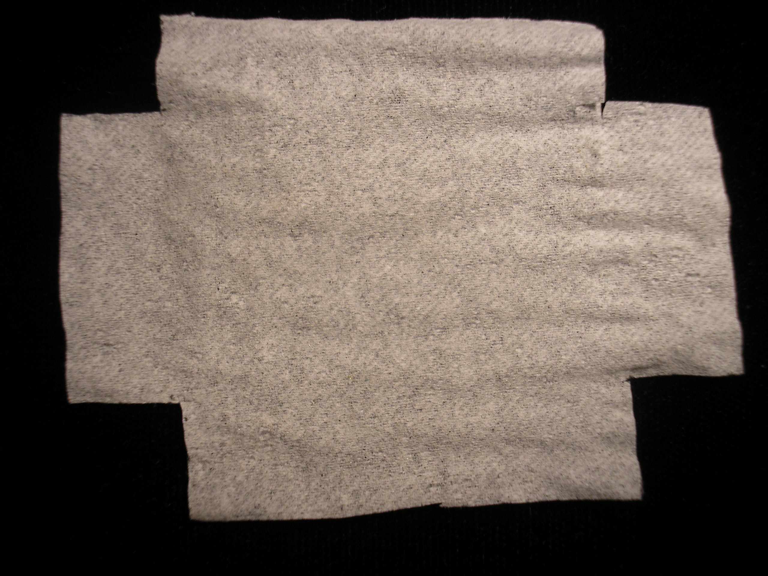

Very thin single ply tissue

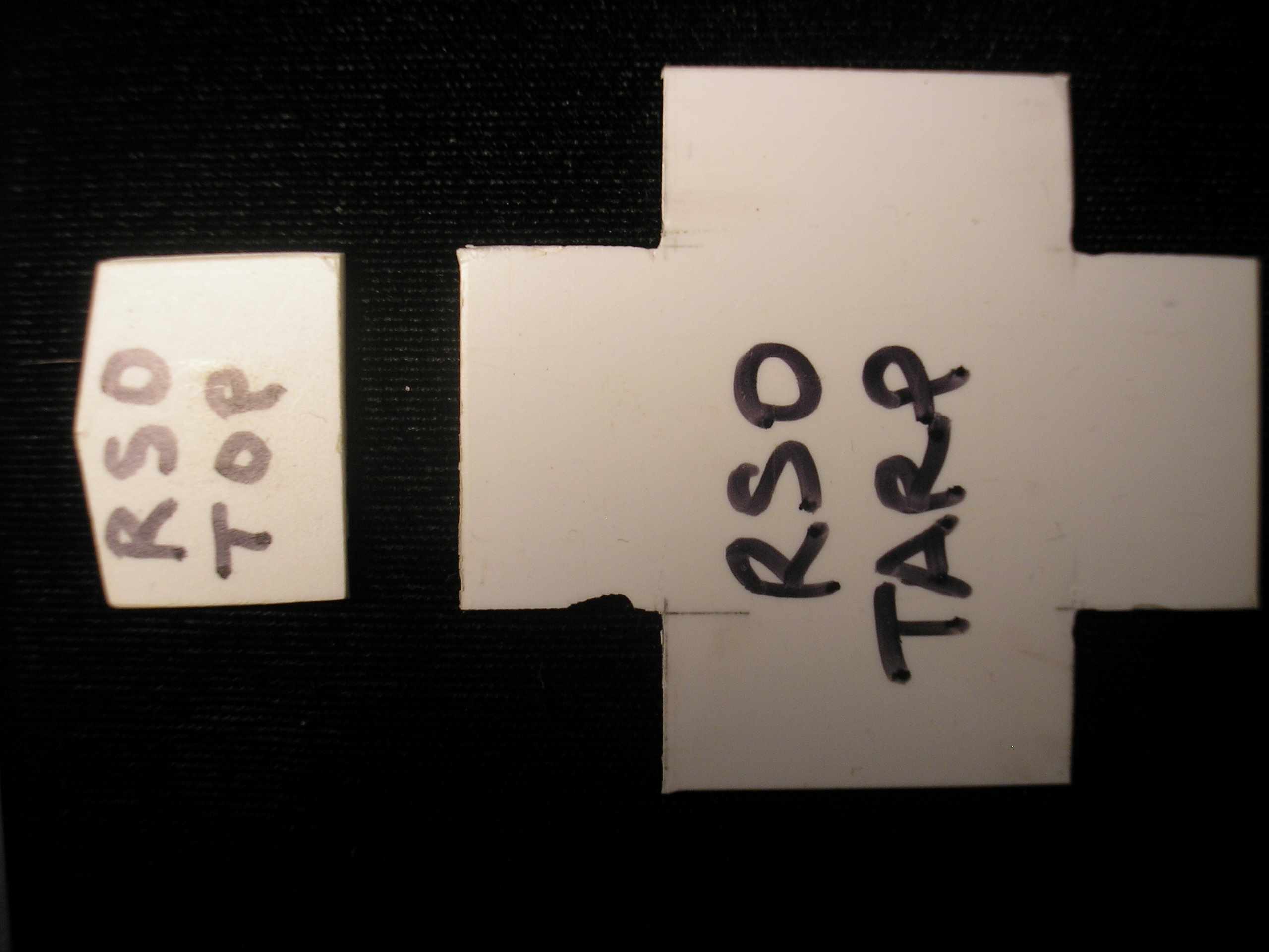

Tissue pattern to cut around this one is for an RSO tractor
.010X.018 hardened brass for tarp supports.
